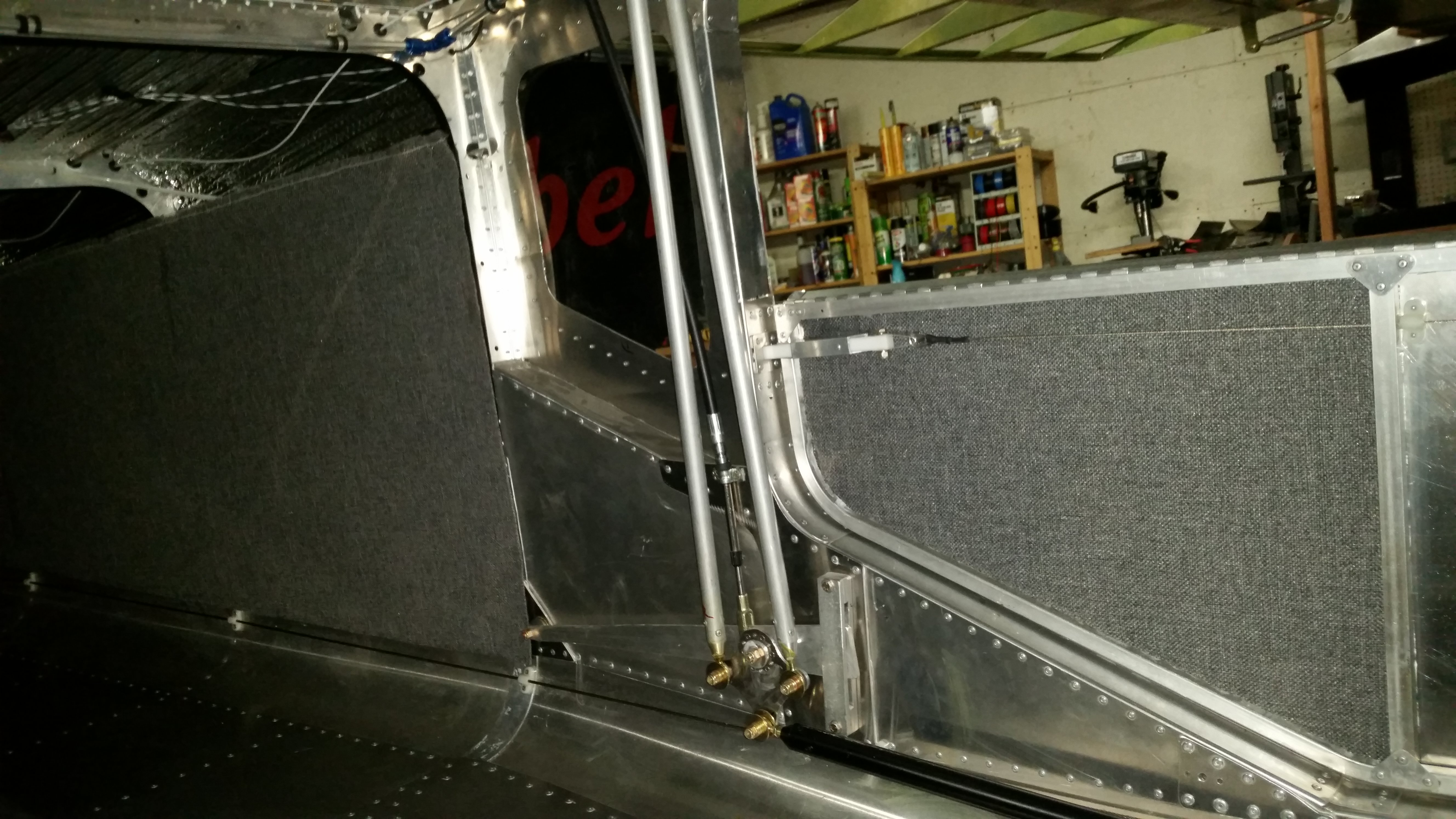

I used the simple cable on the inside
I glued fabric to the foil that has air bubbles inside
Very cheap at home depot
Also I used chafe tape around the outside door frames because the door vibrates in flight and was wearing on the outside skin badly.
Hope the pic helps
Tom

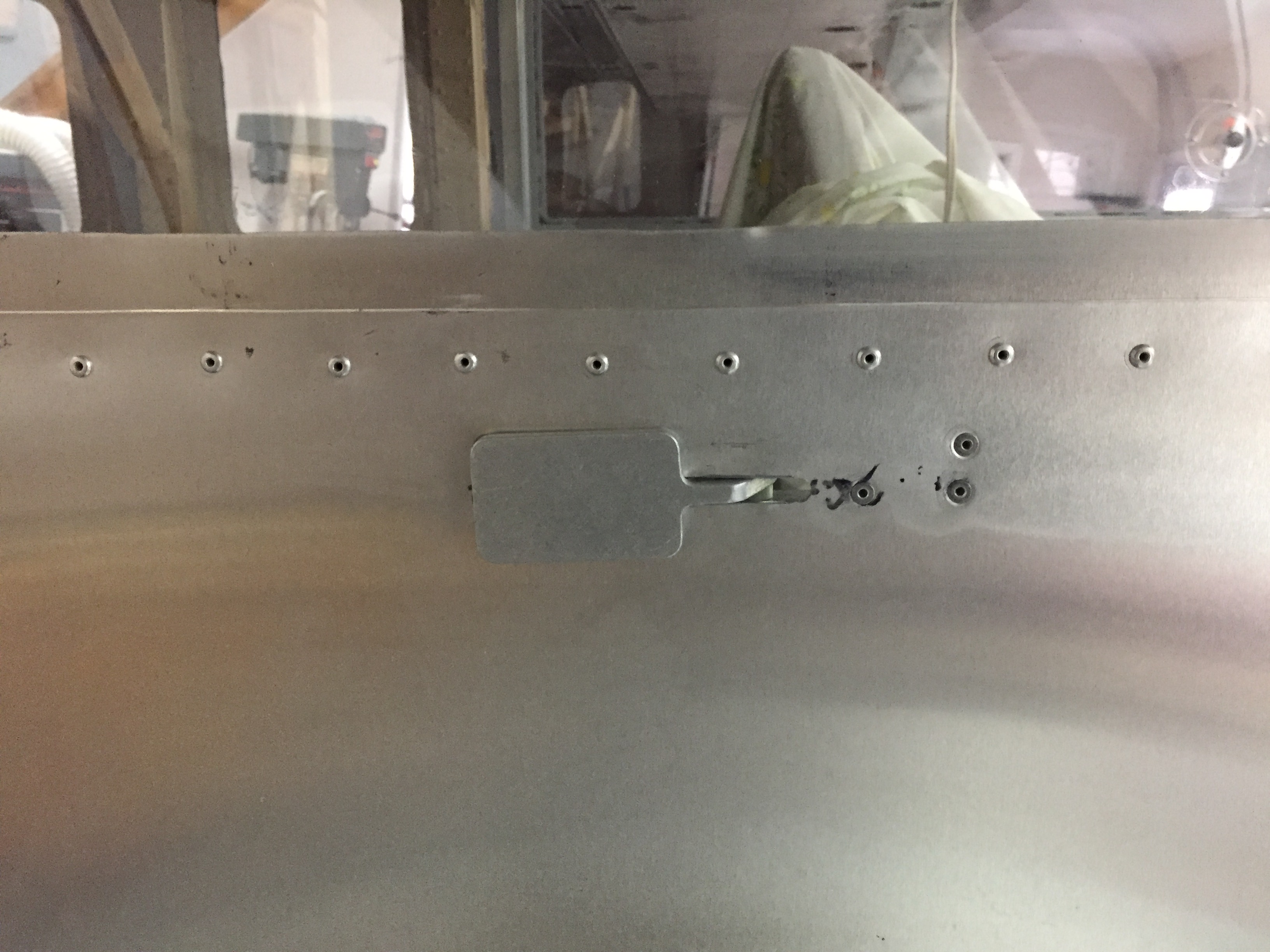

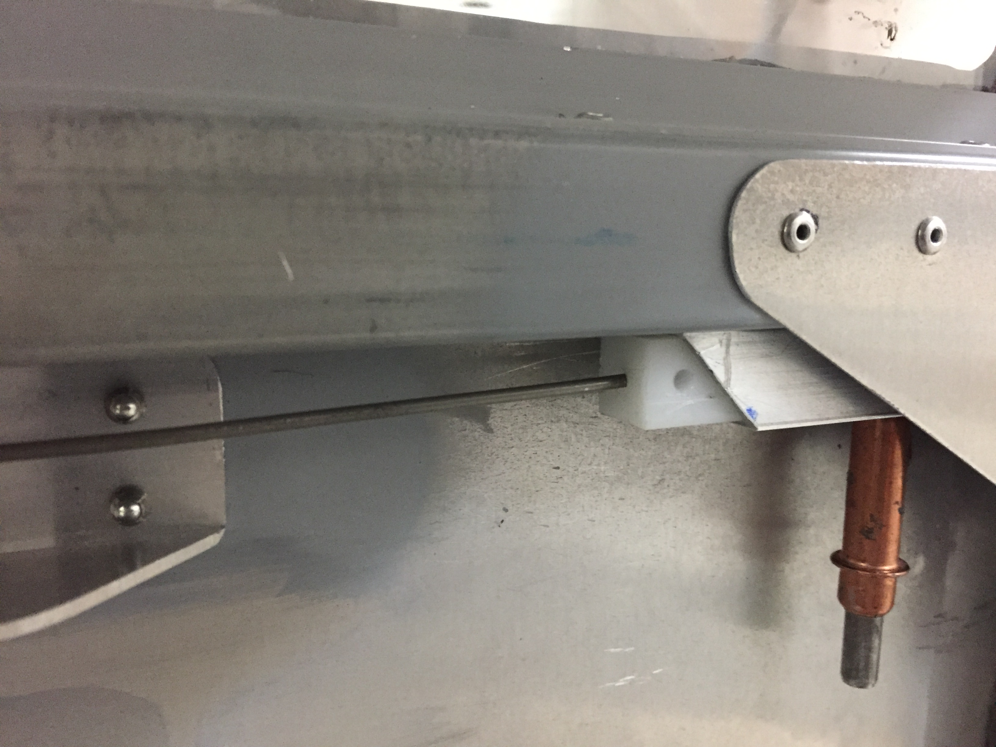

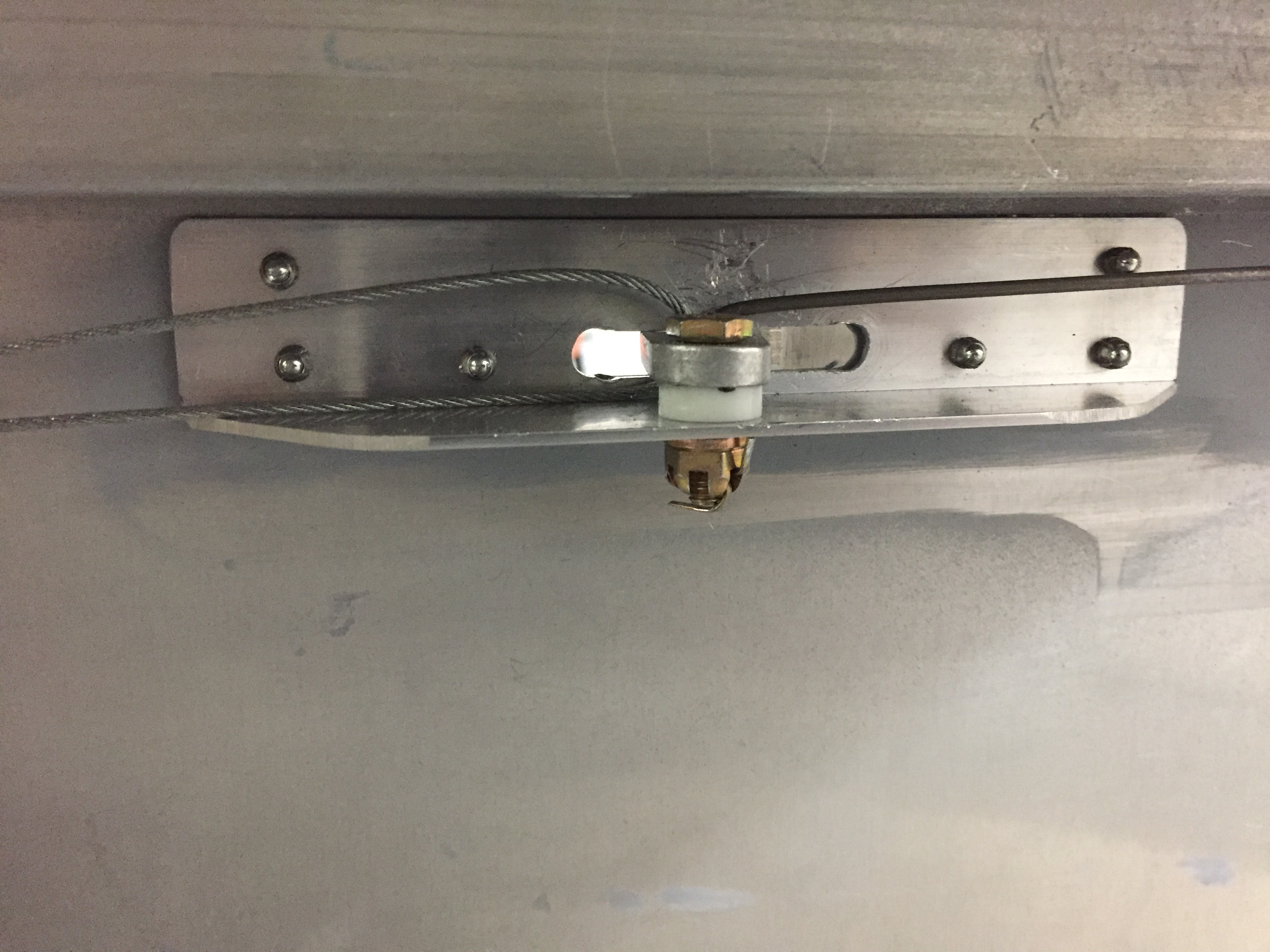

Today, I made the latch for the passenger door based on advice from Fred Darnell. I used a 1 inch piece of soft aluminum angle on the inside, and bolted the outer handle hole to it with a nylon bushing. This allowed the handle to fold aft instead of forward as in the Murphy plans. I used a piece of case hardened steel (Bowden Cable) to connect the latch to the delrin sliding block. I will go forward with the 1/16 inch cable but had to order some nicopress sleeves. Fred had a good idea on an interior handle and I'll incorporate that as a pre-planned product improvement. In the meantime, the 1/16 inch cable will go forward to the next crossmember, a vertical 1 inch square tube, per the plans.
One of the issues that encouraged me to go in this direction was the way the Murphy supplied paddle handle was pre-drilled. The inner hole allowed no clearance from the aircraft skin or the doublers to install a bolt per the plans.
