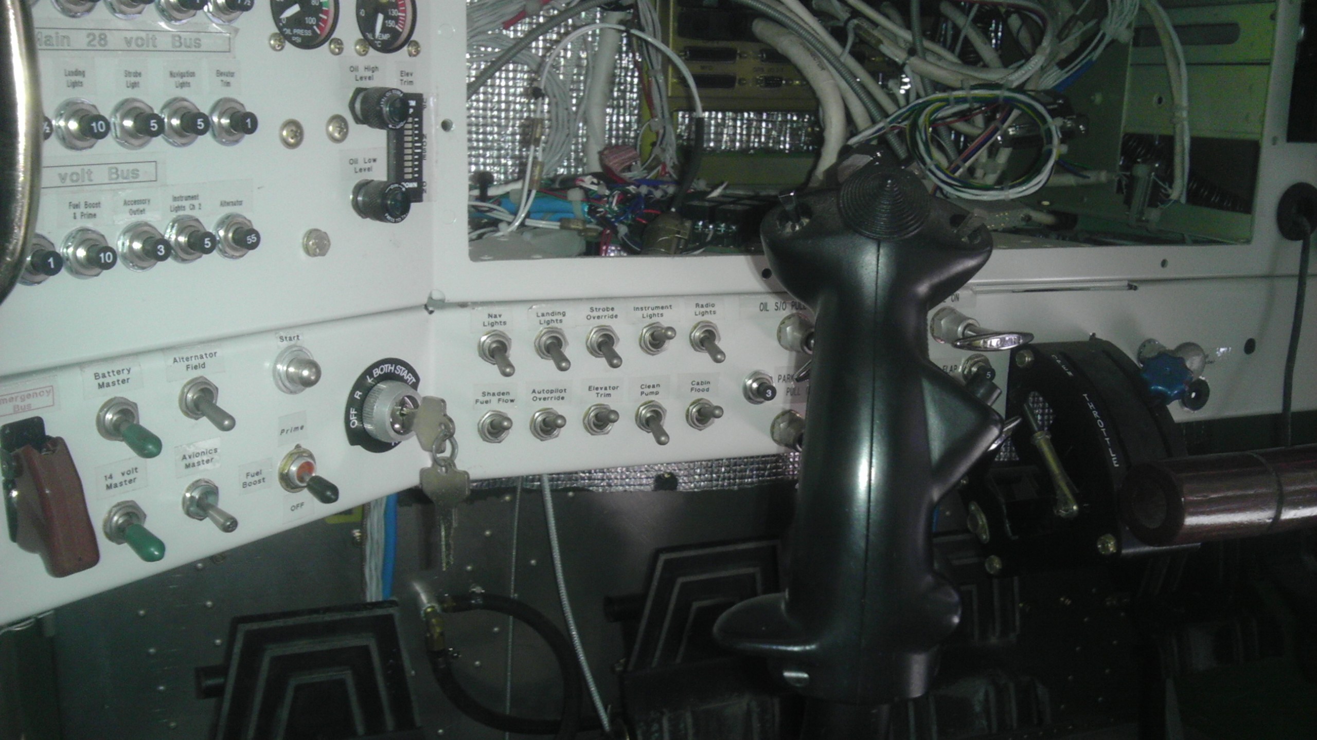

This what I did for my Moose. The center of the panel with the instruments is a removable panel (currently removed)
I went most of the way across and I used .040" 6061. I found by folding the seams top and bottom and using the thicker sheet it was fairly solid but for the throttle etc you would need to reinforce it a bit.

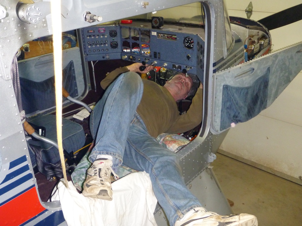

That through the panel access is great. Another tip you might can still do is make the control stick base removable. It is no fun to lie across it while working under your panel! Even with the panel openings youll still need to get under there from time to time. Craig

Craig's talking about the Rebel / Elite... the entire control column is on the floor, not buried like the SR. No matter how much planning... you'll spend hours like this, especially when you're in the refurb business. The first thing I do is drill the column off the floor.
