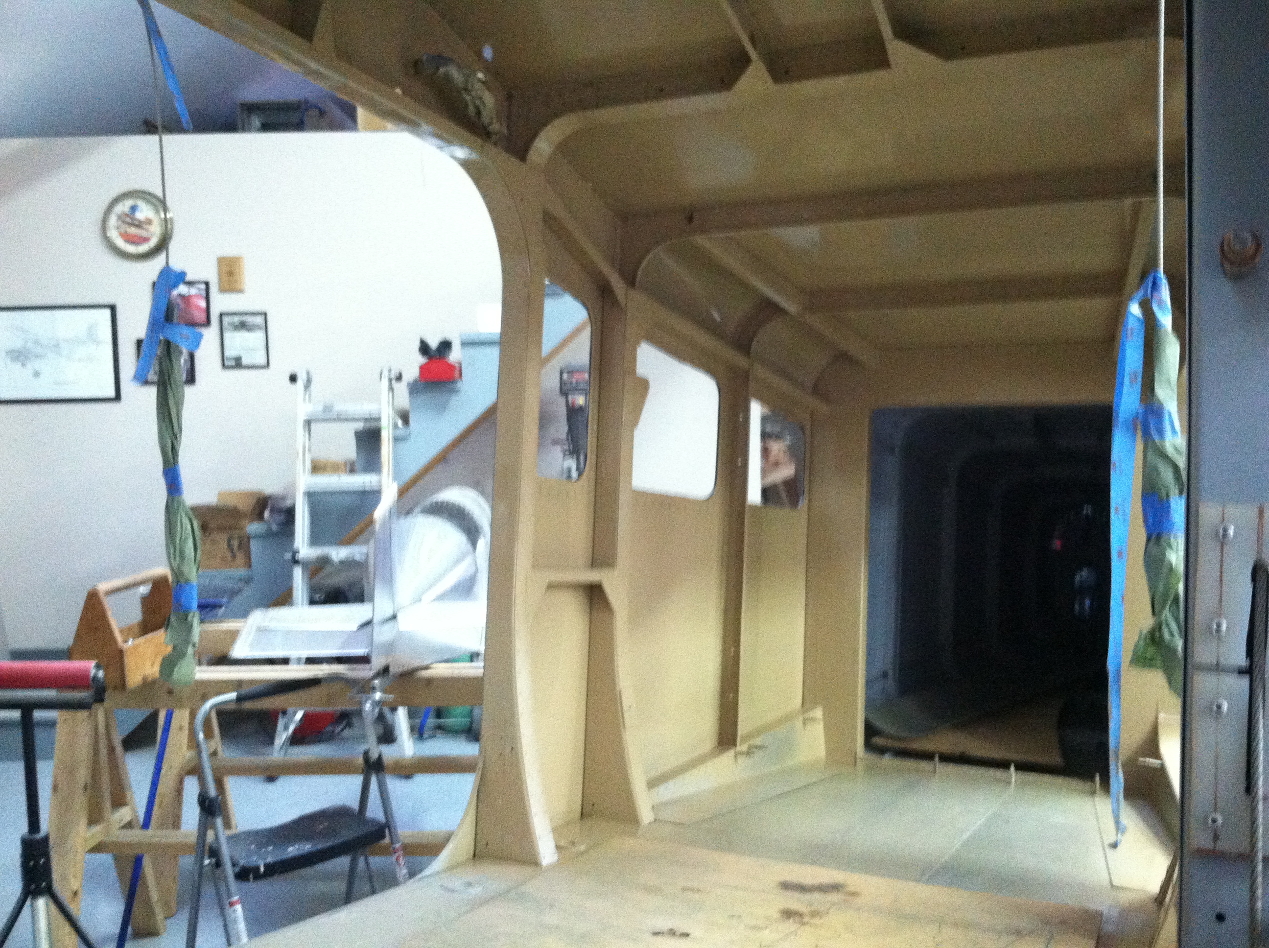

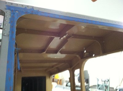

Well, yesterday I donned the paint suit and full face outside air respirator and crawled in. When I climbed out, I was a mess. My overall objective was to fit all the powder coated control gizmos and then remove them and paint rather than tape and paint around. It worked out really well. There are lots of nooks and crannies and it is very difficult to get in all the corners etc. wearing all that stuff.
Biggus, I used an Australian paint, MetaCryl. A friend had used it on his RV-8 and I was impressed at the lack of overspray. Its a very high solid polyurethane and consequently requires very little pressure and sets up quickly. I set the regulator at 30 psi and only 20 at the gun. I ended up with one run in a corner that was my fault -- simply too much paint. Overall, I'm very happy. I still need to paint the floor, but that's easy as I have it out most of the time.
