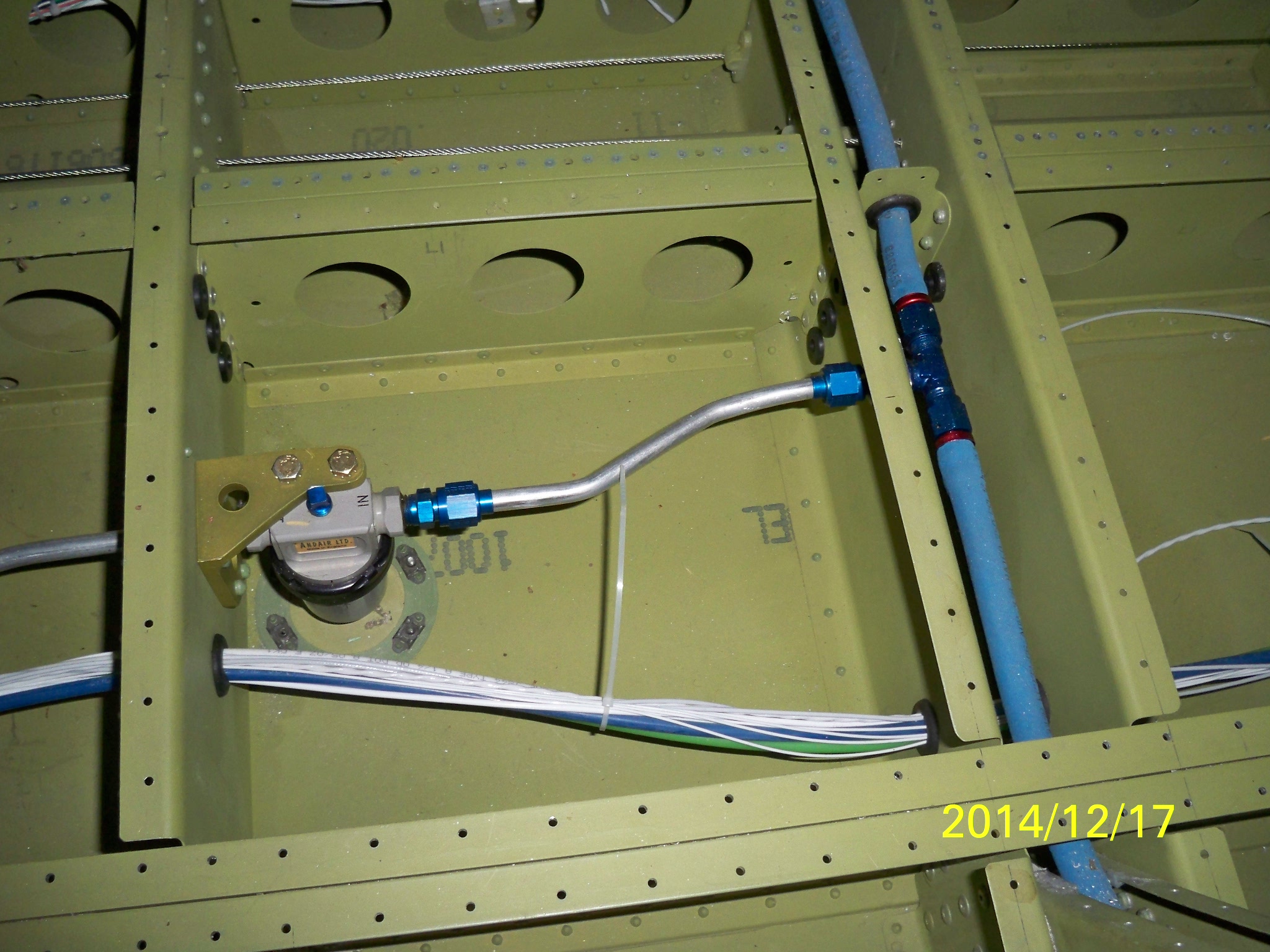

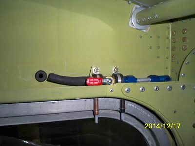

Lesson learned, run all fuel lines while the fuselage cage is still open! That said, I finally got them installed. I used the stock Murphy valves at the root rib inside the fuselage, but then used aluminum AN fittings through the rest of the system. I ran them aft and into the bulhead, using a piece of PEX to eliminate chaffing, then installed a coupling and then down and across the floor, where I tee'd them together on the left side of the fuselage. My intent is to run a single line forward to the firewall from that position. I've seen many different pictures and ways of installing a gascolator. Some have put the gascolator under the floor at the low position. Others have installed some type of line drain at the low point and the gascolator on the firewall. My primary concern is easy access. I would appreciate your thoughts on where to position the gascolator, low point or on the firewall with a drain at the low point. Also, how to best attach the fuel valve to the root rib.

Hi Jerry,
I mounted the Murphy supplied fuel valves using an angle riveted to the top door channel and two Adel clamps to firmly attach the valve to the angle. I will also add a spacer between the back of the angle and the wing rib to eliminate any movement of the angle/valve during actuation.
I am using a gascolator mounted just in front of where the fuel lines tee. I used a 1/4" angle to mount the gascolator to the bulkhead, and a channel on the other side of the bulkhead to make the setup very stiff. I didn't want anything moving during fuel testing. There is an access cover underneath for removal of the gascolator bowl for inspection/cleaning.
I have an electric fuel pump mounted forward of the gascolator and then the aluminum fuel line running forward to the firewall.
