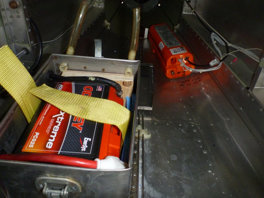

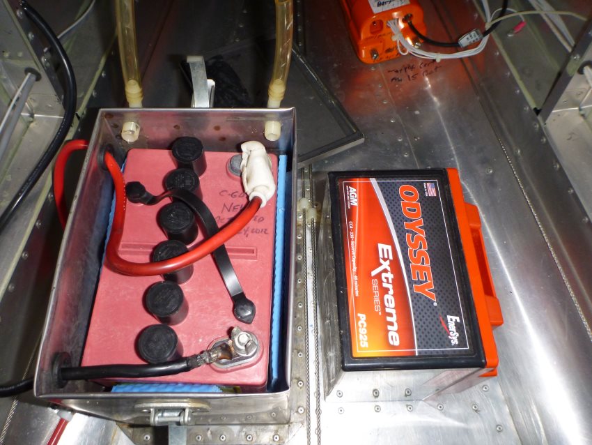

I've been flying DJK since June of 1995... 19 years coming up quickly. I bought my first Gill 25 in 1994 with high anticipation of flight and it lasted almost 10 years... the next one 5.. the next one 3 and the last one won't even hold a charge for more than a few days, installed May 2012!
Even when they are new and fully charged, they have always cranked on first hit to TDC and stopped. Then hit it again and they'd start the airplane. Over the span of time I've had to have my starter rebuilt twice. Freshly charged.. when I hit the master on my volt gauge has always been slow working it's way to sweep up to 12 volts. Some days I even tapped on the glass....
I almost bought a new battery AND a "field" starter vs the permanent magnet Skytec I've had all these years, but Walter Klatt said try the battery first.
Finally got an above -10C day and some sun today to make it work friendly in the hangar. I installed an Odyssey PC925 today.. and the difference is like night and a BRIGHT day! I could taxi on the windmill effect alone and this was the battery right out of the box and already 5 months old. I checked it and it was only about 80% charged and figured I'd start there. On hitting the master switch the volt gauge snaps to attention now... and the cranking speaks for itself!
The old Gill Battery.. darn near dead albeit.

Yep... in the tail... I just looked for something that would fit and almost fill the same box the G-25 came out of!
Weighs 24 lbs... the Gill 25 weighted 21.15

Everything is fine Dick... the last couple Gill's you can have them fully charged and then come out two days later and it won't crank the airplane. Then throw a smart charger on them for a very short time and you'll get a green light that they're charged again and will start the airplane. I think the plates are touching in them or sulphating.. I wasn't overly impressed when I bought a new one in May 2012 and it arrived DOA with a cell that wouldn't charge and I got screwed around for 2 weeks to get a new battery and got stiffed the shipping twice!
I can start it.. fly around.. go park on a lake somewhere and it will start again a few hours later (albeit the same stop at TDC and then go on the second try)... so the charging system is working fine.. 14.2 /14.4 volts on the meter in cruise with radio, lights, strobes and landing lights on. I have a Honda voltage regulator, that although was a PITA to wire up compared to a simple Chrysler on/off, has worked like a charm for 18 years.
The Gill from day one has never gave a good crank and I think actually was cause for 2 bendix failures on my skytec PM starter. Thankfully they're an $11 Ford Van part..
As noted I put this Odyessy in, at only about 80% capacity and as you can see in the video it never even considered hesitating at TDC.
