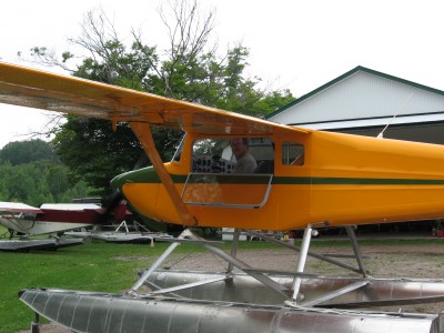

The Elite in the pictures acquired said cracks in less than approximately 25 hours as well. I looked that bird over REAL good.. when it was here for over 200 hours of work, installing floats with every bell, whistle and warning system known to man. Reinforced the nose/floor pan and a few other things as well before it left. There was no visual evidence of stab cracks when it left my field.... to fly across Canada to Vancouver Island.
At the same time I look after another 180HP Elite on Clamar 2200's that we watch like a hawk, that gets flown hard and regularily. It hasn't shown any signs of fatique cracking.

Wayne, is that to say that the Elite in the photos acquired the cracks within 25 hrs after leaving your shop? How many total hours?
How many hours on the other Elite you look after?
Dave

Yes Dave... as far as I know, at least not obviously visible like they are in the pictures, there were no cracks evident while it was here. I flew it out of my field to CYEE.. it was then flown for about 5 hours for dual training for insurance purposes and then John flew it across the country to his new home in BC. Cracks found very shortly there after.
Total time.. I do not know, do not remember how many hours were on it when I installed the floats... but it was very few. The one that stays here, I'll find out when Bob comes over this week with his lower cowling that he took to the body shop for some mods.

Good chance it's prop pulses... that's how it started with the Moose with the Paddle prop beating the hell out of it running on the radial. I had a CH701 that I switched from a wood GSC prop to a Warp Drive prop a few years back and AFTER a flight the lexan windshield would shatter on the pilots side!
The Elite in question.. with cracks.. left here sporting a Sensenich aluminum prop, as far as I know it's still on there.
....also notice it has reduced elevator spade width and rounded tips.

WalterWalter Klatt wrote:This sounds almost similar to the Rebel left elevator issue with the outside rib and skin doublers needed there. Is it always the left side where this happens?
The photos of the Yellow Elite in the archive show cracks on both sides, don't now about the other one.
