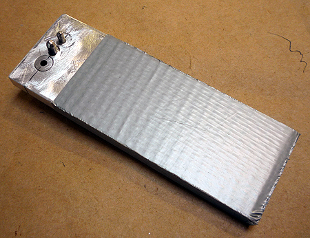

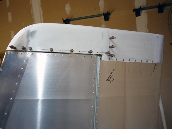

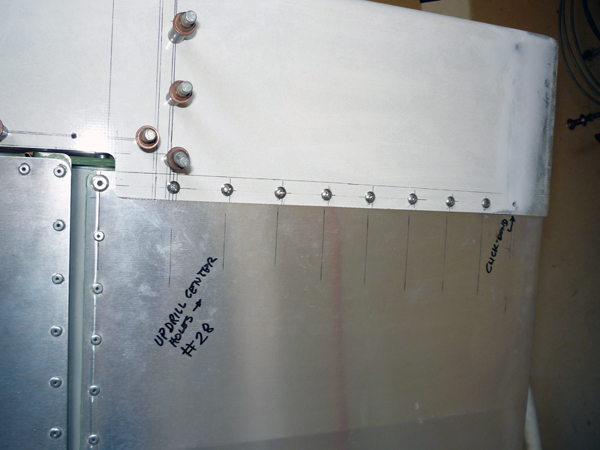

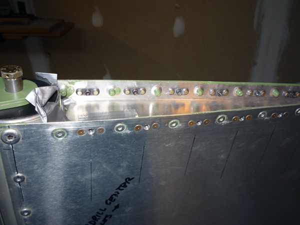

I installed mini nutplates on R662 for #6 screws. The screws and heads were just about the same size as a standard 1410 rivet for a pleasing visual. The nutplates/screws are spaced per the MAM manual rivet count specification. Probably could have got away with using half the number of screws on the rudder. Figured with the lead cantilevered on the leading edge of the elevators, a few extra wouldn't hurt (couple of ounces), so I made them all the same count. Just me I guess.
Also made a nutplate jig (see "Nutplate Jig.jpg") for the project which made drilling the ears relatively simple. Do have to admit that the installation took extra time to accomplish, however, I am going to do the same on the wing tips. Also, on the last nutplate location at the trailing edge, I had to resort to a pulled rivet because of tight quarters. I know that there is a solution to installing a solid rivet for tight quarters like this, but didn't want to fuss with it (as an option, I could have not installed a nutplate at that location, but that is just me).
You can also view the surgery that was accomplished to "lengthen" the tip leading edge and "squared up" the trailing edge of the fiberglass tip on photo "Tip Nutplates2.jpg".
