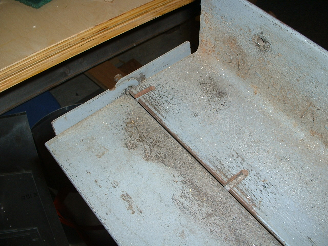

Re: homemade bending brake ?
My bending brake was built 30 years ago following plans purchased from Zenair. It is 48 inches long, and is made from 4 x 4 x 1/4 angle. It is a little different in that the pivot point for the bend is actually located on the centerline of the radius of the hold down angle. See picture. The cutouts were made some years ago so as to form adjacent legs on a gusset. This will bend 45 inches of 0.032 pretty easily, but long length of heavy material can be troublesome.
Tim Hickey
