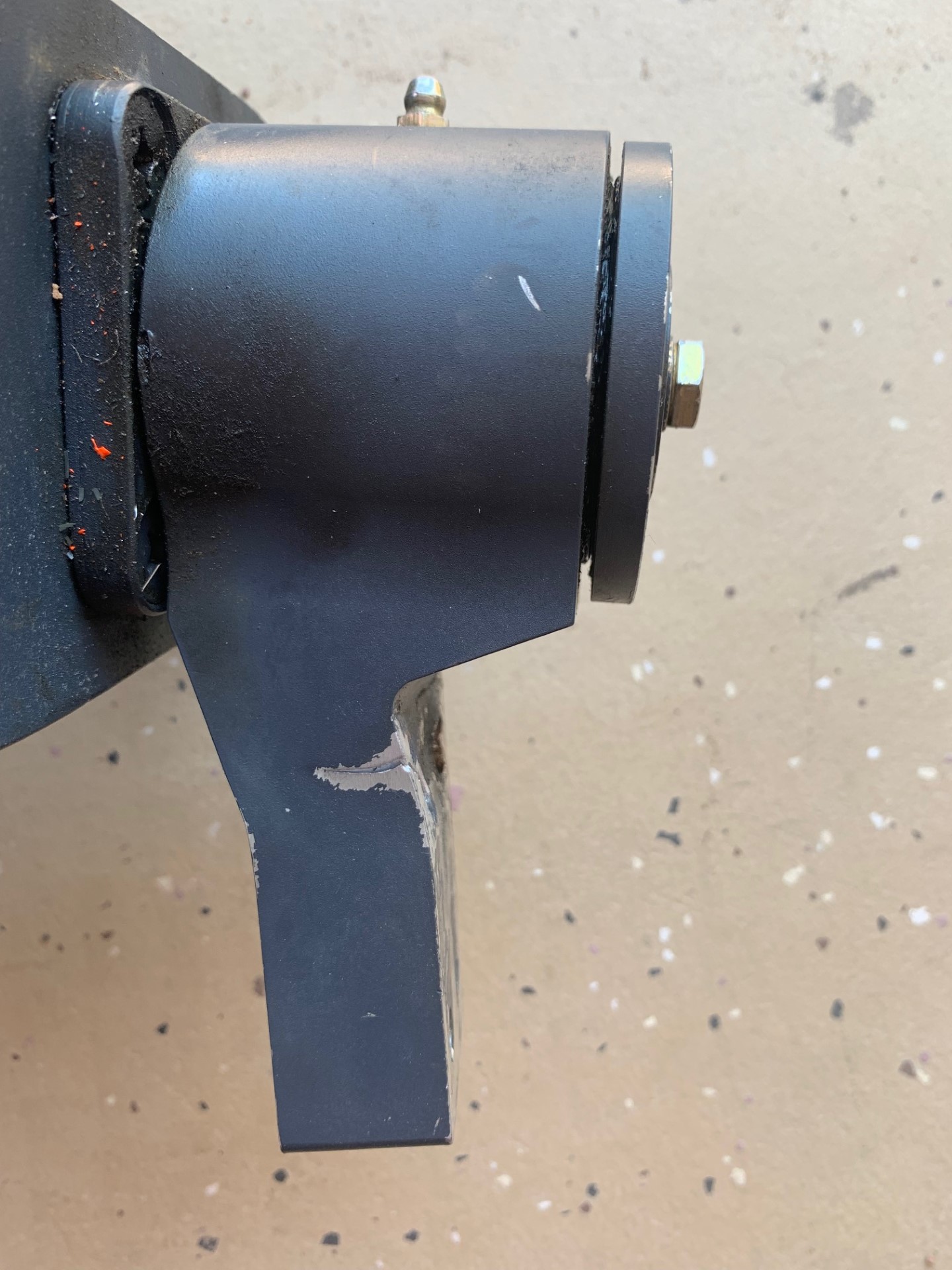

Below Photo shows sideview of mount, the bottom of the flange normally is straight

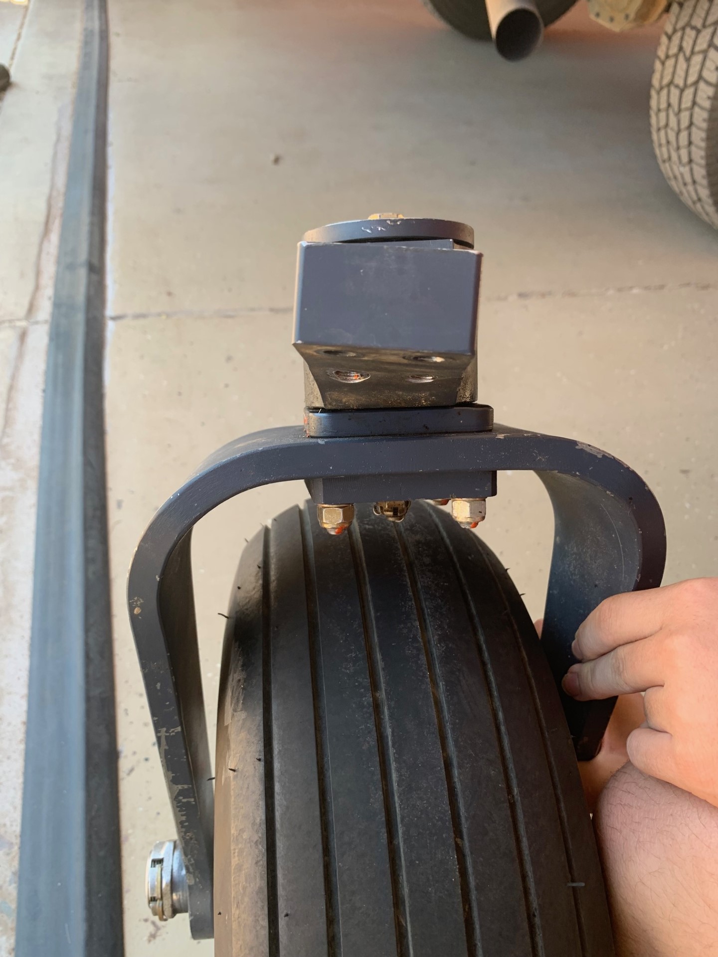

Below Phot show 6 deg twist
