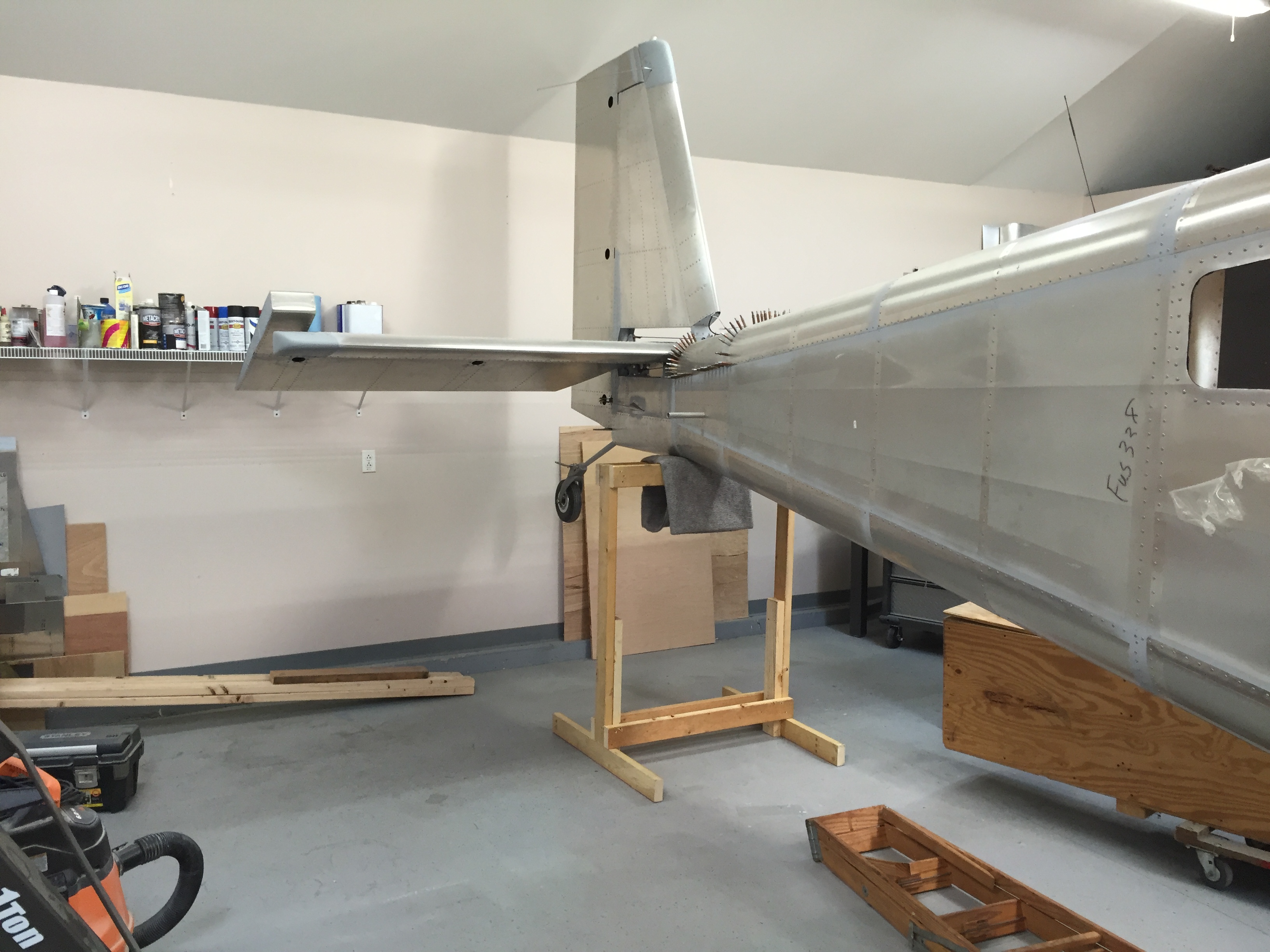

Go to my website and you can see how I did it with 2X4s and a little help from my friends
http://www.whitetaildeerfarmer.com/Airplane.htm The picture of the stabilizer shows it better that the one of wings but you may get the idea. After we got it up we fitted the struts. Make sure that your fuselage is perfectly level and cant move.

My 2x4 system is a lot cheaper then renting a scaffold or sheetrock lift and it is less clutter in your work space.
You just raise the cross piece up to the desired level and clamp it with a c clamp or vise grip. When you are satisfied with your height you screw it on with torx screws. If need be you can use some window or door shims taped in place to make final adjustments

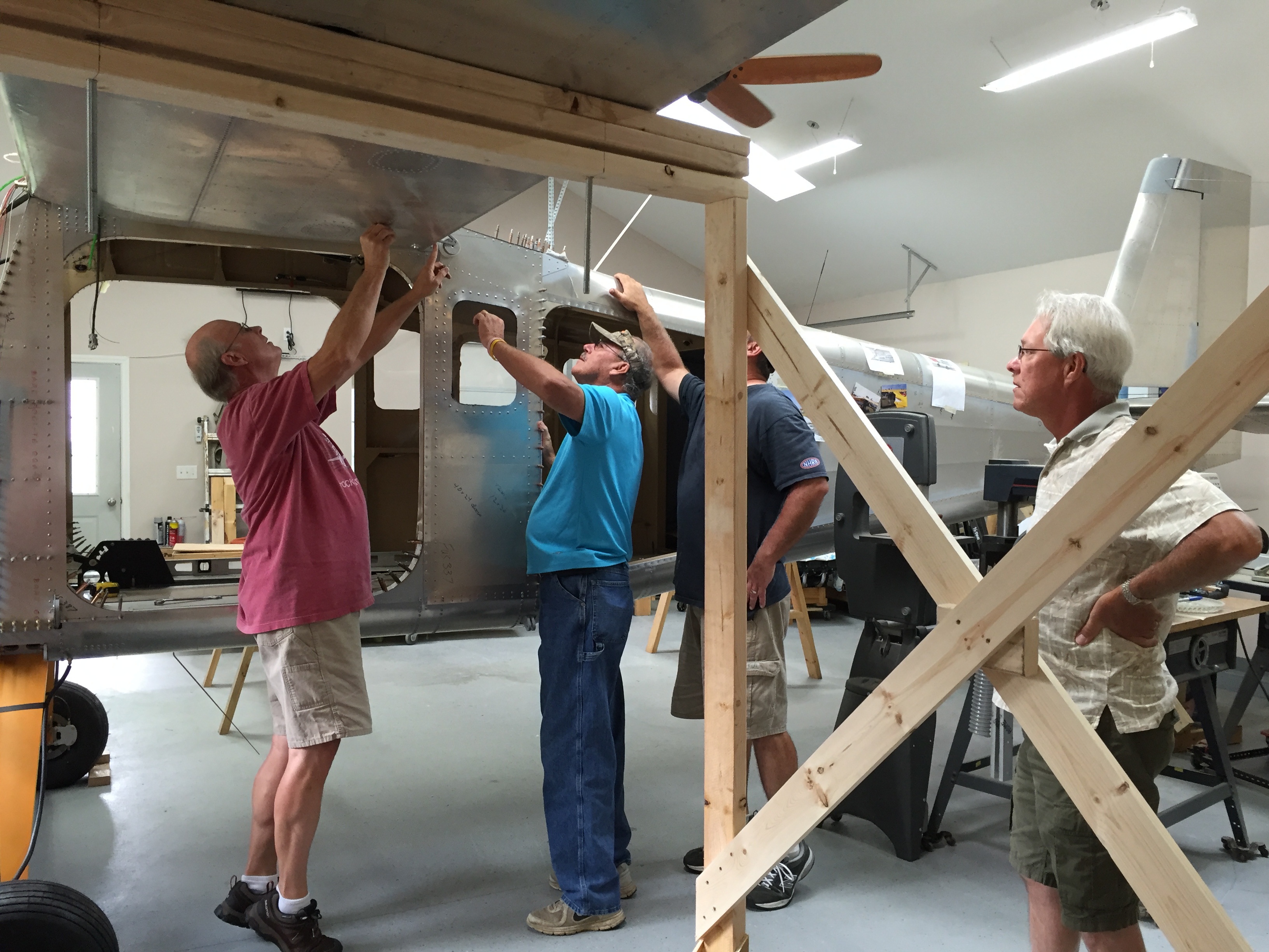

I'm finally getting around to mounting the wings. I spent too much time on restoring a Cygnet (1989 Reserve Grand Champion at Oshkosh) to get it to Oshkosh this year. Now I'm back on the Super Rebel full time. For those of you who are retired -- full time is relative. The refrigerator coils froze up this week, my wife hit a curb and blew out two tires, and I had to spend a day troubleshooting an electrical problem on the John Deere.

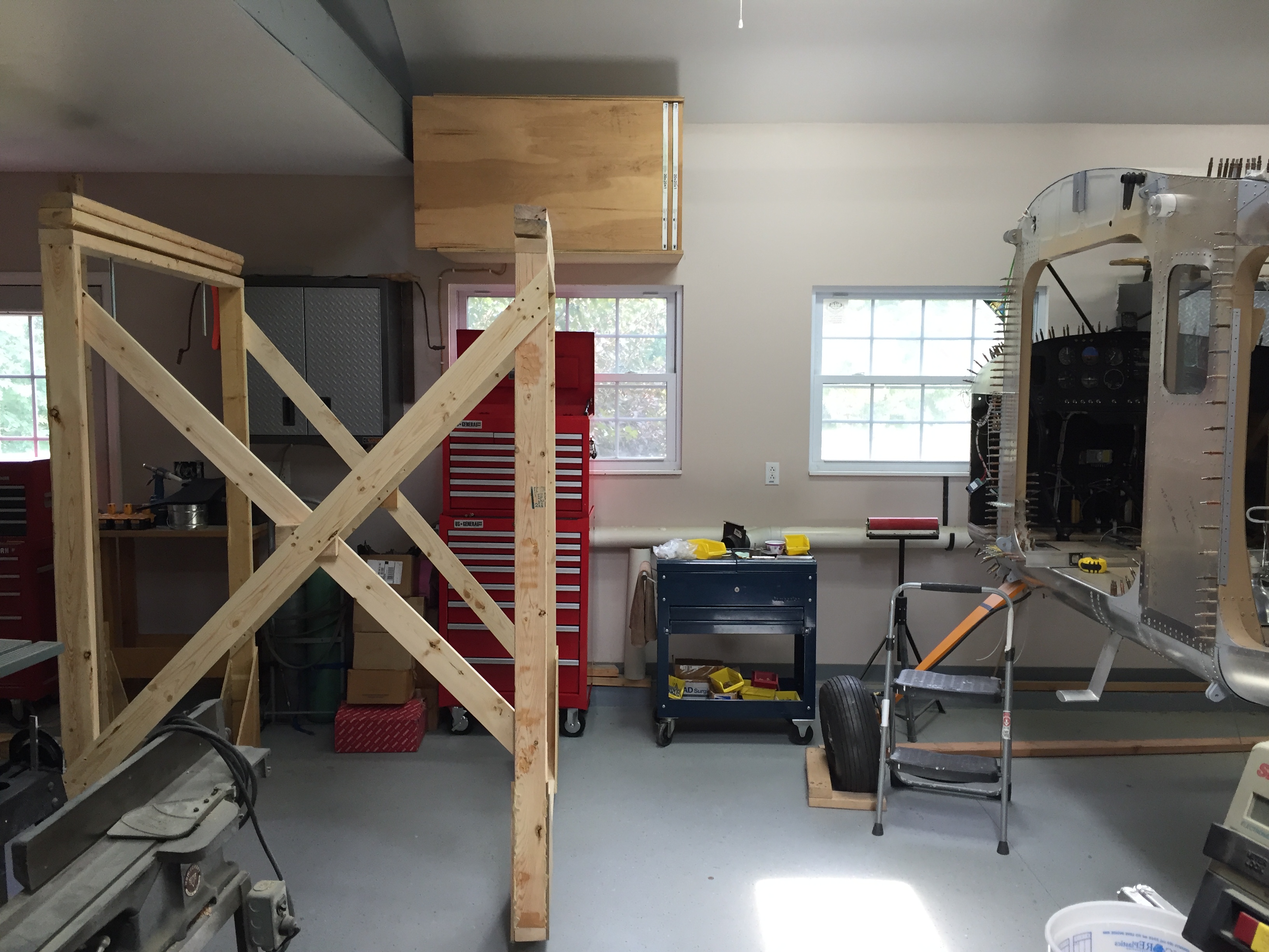

So, this morning, the tall strong men in the neighborhood will help me lift the first wing (left) in place. I've turned the aircraft 90 degrees in my shop, and will have a bit less than one foot on each side to spare after I put each wing on. To do this, I've built a fixed stand similar to the one Wayne described, actually from some pictures Charlie Starr sent me, and the adjustable and movable stand Tailwind described. I've attached a photo below. The plan is to set the wing in place on saw horses, put guys on each corner (and then some) to lift it up high, then roll the adjustable wing stand underneath. I can then maneuver it to fit and then put the fixed stand in place. I will then disassemble the adjustable wing stand, slide it under the aircraft and reassemble on the other side to fit the right wing in place. I'll add more pictures later today.

Success!!!! I'm really happy I made the adjustable/movable wing stand.

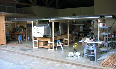

The Elite wings do not weigh near as much as your Super Rebel's. Here is my scaffolding setup when I first mounted the wings and cut the struts. Amazing how accurate you can get things dialed in just shimming off your scaffolding. The most important item was waxed dental floss stretched between wing tips. This was used for very accurate measuring and getting dihedral correct.

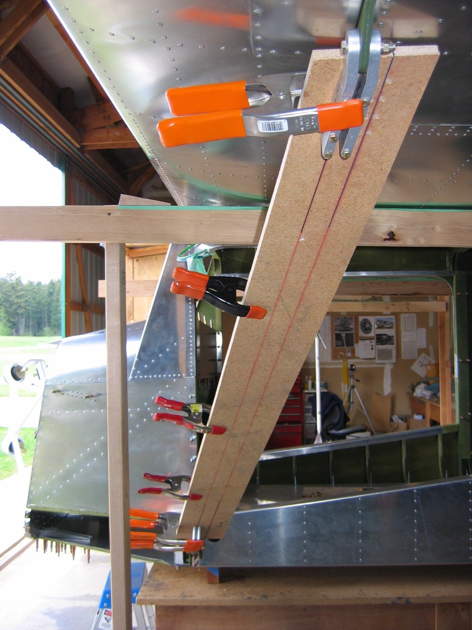

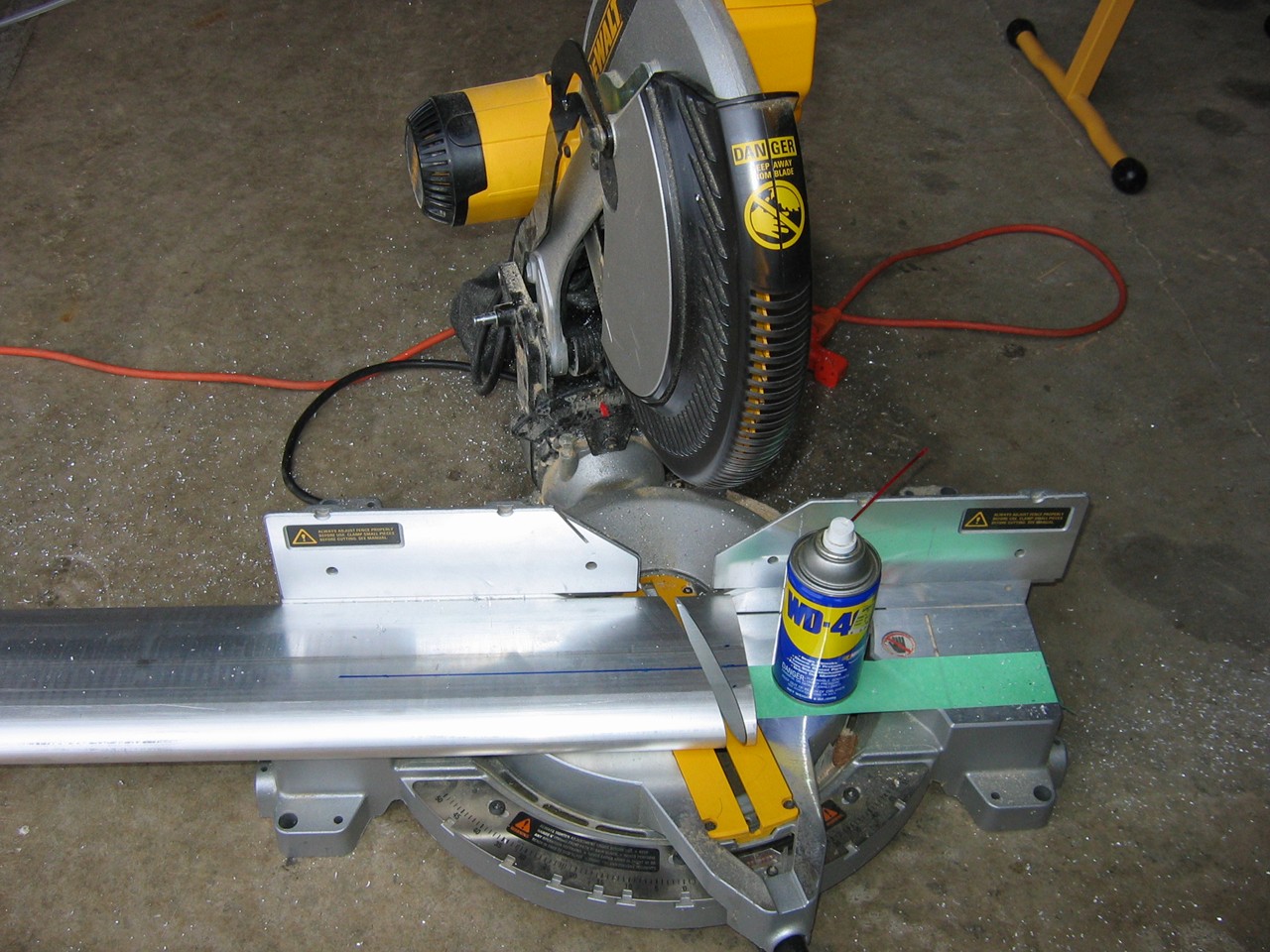

After getting your front and rear attach holes drilled and reamed, next is the scary job of cutting your struts.
I made test pieces out of scrap wood and MDF. This let me get the cut angles and lengths correct before going after the expensive real struts.
I used a chop saw. It was over in a moment...and cut correctly! Whew!!!
Eric
Elite Amphib N645E
